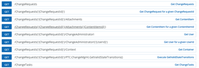

I'm Trying to get the Associtated reference objects from windchill odata services but there's no API related to that object, but in Endpoint Description they mentioned about that as shown in above image.  Any leads or solutions are appriciated.

Hi @RC_10864577
What reference objects are you expecting that should be returned?
The description of reference objects point to each change type.
Here is example of Change request.
But this reference objects are linked to the change object not WTPart or EPMDocument or WTDocument

I'm Trying to get the reference object or an ECN.

Hi @RC_10864577
You said Reference objects but you haven't mentioned the type of source object.
I've provided example for ChangeRequest, so you can find same API for others change types.

Hi @HelesicPetr, for me there's no endpoint which you have refered...

I was in doubt regarding version. Thanks!!!

Hi @RC_10864577
Actually I used Windchill 12.0.2.7 but newer versions contains also additional new APIs
I also have more development instances as versions 12.1.2.+, 13.0+
