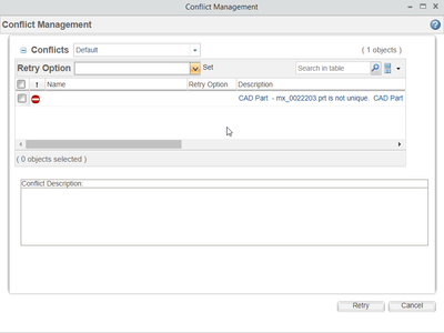

In an attempt to restore the mistakenly deleted instance, I tried adding it back using a copy of the family table stored on my desktop. Unfortunately, I encountered an error message stating "CAD Part XXXXXX is not unique."

  • I've tried adding the instance back using a copy of the family table stored on my desktop, which resulted in the problem stated above.
  • The deleted instance still exists but cannot be opened.
  • I cannot check-in or undo check-out the Family Table due to the conflict, presumably because the drawing still exists.

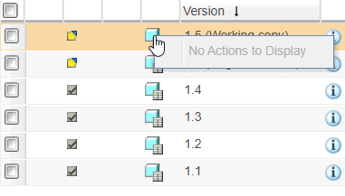

Go to the History tab of that generic. Select the iteration that had the deleted instance. From its page, you can add to the workspace. You will get a conflict saying its already there but you can resolve that and the older iteration will be downloaded.
Okay, here's the History Tab of the Generic model. Version 1.5 is the current saved version (in another workspace) with the deleted instances. Version 1.4 is the last version without those changes. Nothing is showing when trying to add it to this same workspace. Should I do it in the original workspace? Add the previous version in that workspace?

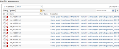

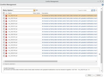

Undo Check Out Error:
I'm trying to do what you're telling me, I was able to undo check out the drawing from the instance that I deleted it.
How can I bypass the update to undo check out?

Was the generic checked back in yet? If so, its gets more complex. Based on what you are saying it appears like you did. Ok, here is what you are seeing. If you have  a drawing that uses the instances that are deleted, its causing a conflict since its pulling the latest generic which does not have that instance. The epmdocument of that deleted instance is left behind so you would need the out of date generic in the workspace to be able to retrieve it.  This is why its often a good idea to never delete instances if they are checked into Windchill.  You can add older iterations of the generic to a workspace. Long term, you need to restore that instance which the article will walk you through.
