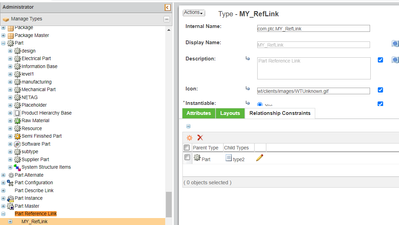

@BenPerry try by creating a subtype of the WTPartRefLink , the new sybtype should reference only  your give doc subtype
we can then use the new soft type link in mapping , didn't test this but theoretically should work  .

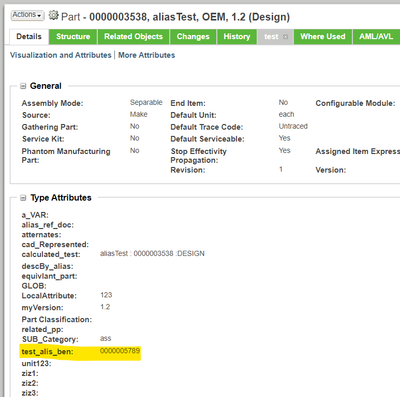

@BenPerry I got it working with OOTB referncelink , used below mapping
referencedBy@wt.part.WTPartReferenceLink~references^wt.doc.WTDocumentMaster~masterReference@com.ptc.myRefDoc~number

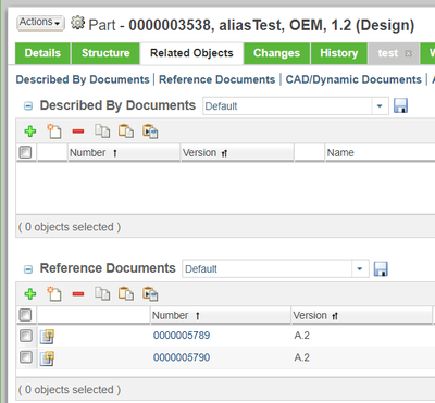

a part is having 2 ref doc one is OOTB Type and the other is my soft type
on the info page of part only the softtype is  shown :

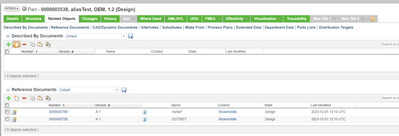

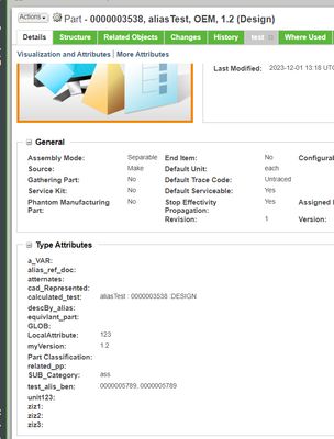

The hook here is that the ref doc is having multiple iterations , the alias will show a value to each one :
