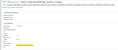

I used the below method to get the "Described by" document name in the WT Part search tab. I would like to have the same for the associated CAD/Dynamic document linked with the drawing.
WTDocumentInfoDescribedBy2 with mapping describes@wt.part.WTPartDescribeLink~describedBy^wt.doc.WTDocument~name (to get name of Described Document)

Hi Amir,
Use below mapping built@wt.epm.build.EPMBuildHistory~builtBy^wt.epm.EPMDocument~name
