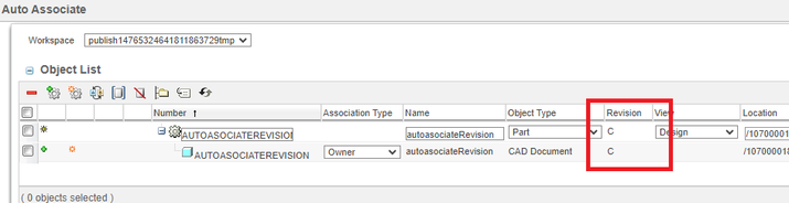

Currently, my setting in Preference Management for "Set Revision for Part" is set to No (I am looking to change this). With this setting, a user could create a CAD object and check it in without creating the WTPart. If after some time passes, and the user creates the WTPart, can the WTPart version be set to equal that of the CAD object. I've done some searching on this topic and cannot seem to find how this could be done. Up to now users have checked out the WTPart, and checked it back in until they have the alignment. I am looking for the process to do this without doing the checkout/checkin multiple times.

If you set the property Set Revision for Part to yes then the system synchronize the revision of the CAD with WTPart during autocreation
Example,
I create CAD with revision C as initial revision
Then the WTPart autocreation will synchronize the revisions
if the property is set to NO then the WTPart creation starts normally with A

BenLoosli
