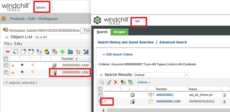

Hello everyone,
I would like to know how I can allow users to see documents that are new in other users workspaces (after it is uploaded of course)
The aim for the user is to see what references are already created in order to name their new parts.
Thank you!

Hello @AdrienKLEIN
I've found solution for you.
Administrator has to grant ACL rule Read for EPMDocument on the user Domain. If you need WTPart grant same rule to wtp.
I recommend to grant it on organization level.
Allow read ACL is enough
result
There is consequence a user can access and just see other users workspace metadata

Thank you for your answer @HelesicPetr .
Of course I can't and won't make all the users admin. Some of them just told me it was possible before (I forgot to tell we run 12.0.2.1, and migrated from 10.2).
Just to eliminate all doubt : I don't want the user to see other user's workspaces, I just wish a user is able to see, with a search in commonspace, the uploaded new CAD from other users.
Only purpose for them is knowing a reference is already reserved or not.

HelesicPetr
(To:AdrienKLEIN)
Hello @AdrienKLEIN
result

Wow it works! I hope ther won't be any bad side effect.
If any, I will tell here.
Anyway thank you very much to all of you, and especially @HelesicPetr , that was exactly what I expected!
