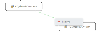

Hi @Zoltán
OOTB the first try works as I expected in the chrome browser.
In your screen there is different type of link I guess.
What version of Windchill do you use?
my example
PetrH
Zoltán
(To:HelesicPetr)
Hi Petr,
Release: 12.0.2.0.
If I can add link, I should be able to remove too.
I must assume the problem lies in the browser(s). But even Edge won't work for me. My Chrome is virgin, I never use it for anything, and have no
extensions.
In Google Sheets it works, I don't get the standard "Open in new TAB", etc. but the proprietary right click menu with the Sheets commands.
HelesicPetr
(To:Zoltán)
Hi @Zoltán
My version is 12.0.2.7 so the 12.0.2.0 can have a bug in your case.
PetrH
Zoltán
(To:HelesicPetr)
OK, just got it verified from support, in 12.0.2.0; the RMB is not working, this issue is fixed in 12.0.2.7.
