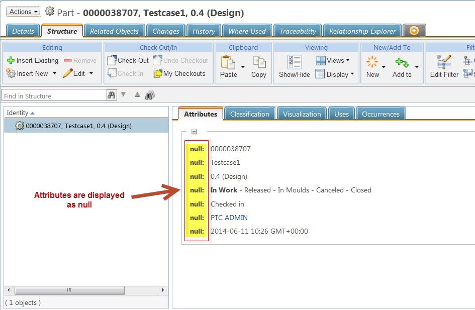

Hi All,
we facing one issue on wtpart, EPM, and wtdoc type objects in Windchill 10.1M040.
issue is, on Structure page, Attribute name shown as null, as highlighted in attached image.
Please help me to solve this.

Hi Vivek,
Are those value coming proper in that part's details page ?
Is there any custom data utility acting on those attribute ?
Method server log which contains the error also will be helpful.
