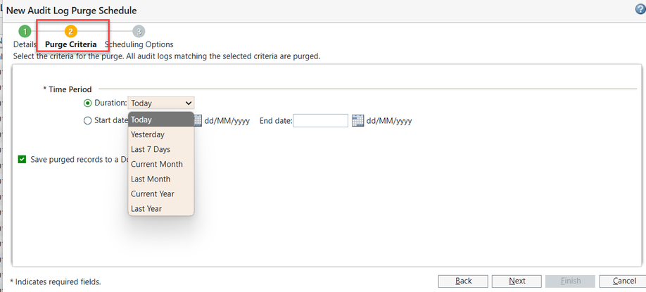

  • Duration assumes you want to purge everything from today going back.  We have "Last Year" and "Last Month" which sound like they may skip the more recent entries.  However, I think "Last Year" will purge out all of 2024 on January 1 2025 and "Last Month" will do the same on a monthly basis.
  • Start and end dates are static, not relative.
Short of customization, I am not aware of any way to do what you want.

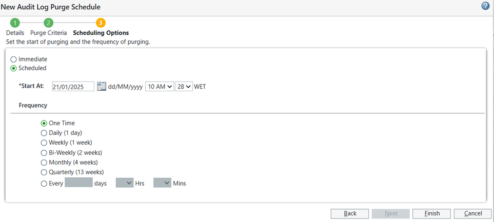

Start and end date of purge criteria are static, this is the main problem. And if you try to select criteria by duration, it doesn't have the option of "keep last year" or something like this.
Of course, you could do it manually, but the end customer does not want to have to take care about that.
Let me share some screenshot to make it more clear to @avillanueva

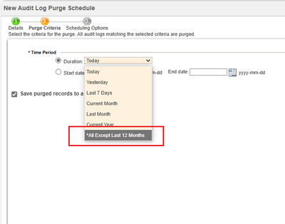

@MaiteFarreny
Is this what you are looking for?

yes, exactly this 😅
