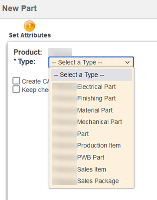

I have hidden some subtypes of parts in different organizations and contexts from the part creation drop down menu by defining a non-existing lifecycle template in the OIR of those types that I want to hide.
When I'm creating a part in Commonspace or Workspace, the OIR is checked before showing what types I can create and the dropdown list of type selection filters out the ones that I cannot create:

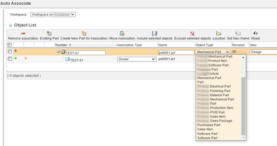

But when I'm using "Edit associations" or "Auto associate" on an existing CAD document, it seems that Windchill just shows *all* subtypes which have "Instantiable" flag on and doesn't consider the context-specific OIR.
Auto associate:

I can create and associate any of those types of parts in Workspace. But when I try to check in, the ACL and OIR are checked and the check in fails.
Is there any way to get Windchill to consider the context/organization specific settings when using auto associate or edit associations? Or do I just need to submit a Windchill Idea and hope that PTC looks at it in the coming decades.
