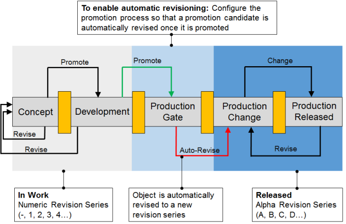

We use a lifecycle template where an object uses numeric revision scheme when it is in the Development state but when it is Promoted to be released to production, it's automatically revised and the revisioning scheme is changed to alphabetical series.
Here is a pic from the PTC help describing a similar process:
Otherwise the lifecycle works fine, but for some reason when an object is released to production through promote and auto-revise, it is not sent to the publisher and we don't get any visualizations or representations of it. The user needs to manually send the objects to the publisher in order to get PDF's and STEP's which is not great.

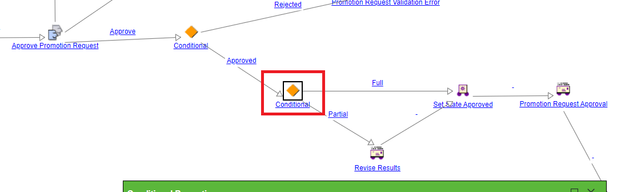

What workflow should I add this custom publish operation to?
I don't think adding this to the Promotion Approval Process workflow would work correctly because the automatic revisioning is happening after the promotion promotion process has been completed. So if I add this code to the end of the promotion process, the publish operation will be done to the object in the promotion process but then the object will be revised automatically to the new revision schema and that new revision will not have a representation.
HelesicPetr
(To:N-Pyn)
Hi @N-Pyn
Yes it is shame that autorevision does not care about visualization :D.
The Autorevision is done in the Approval Promotion Workflow
so if you add the code to the end of process then it will find latest revision and send it to publish queue with "H" priority

HelesicPetr
(To:N-Pyn)
@N-Pyn
The autorevision is done here in the process>
PetrH
