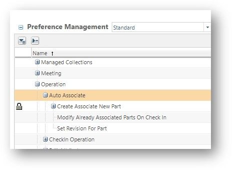

A preference  Auto Relate Drawings To Parts exists in your system version.
Site-> PreferenceManager ->   Operation > Auto Associate > Auto Relate Drawings To Parts

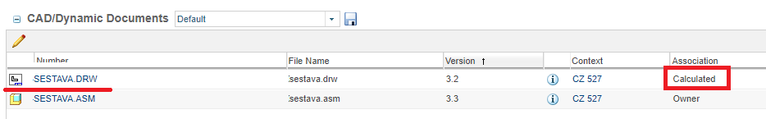

The preference  Auto Relate Drawings To Parts is related to a WTPart object HelesicPetr_1-1672837753866.png not a CAD Model. HelesicPetr_2-1672837780484.png
With this preference you can set what is shown in the WTPart Related Object Tab in a  CAD/Dynamic Documents table.
The preference controls if there are shown drawings from the owner association or from others CAD model links.

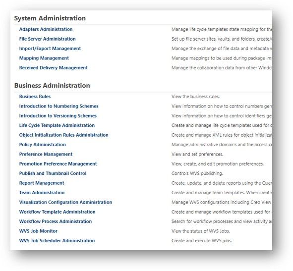

PetrH,
Thank you for your response. So from this I am taking it that this needs to be setup at our top level WindChill system, and not by me with some Admin rights.
So for me, these are options I have available to change, but sounds like it is more at the next up level administration to do this, correct?

Hi @DennisRehmer
Yes.
You can set the preference only on the Org level or Site level.
Preferences on Product/Library level are limited.
