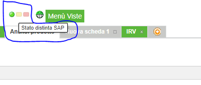

Again with the help of our consultants (I'm not a developer), we implemented a customization that returns, via a kind of traffic light, the status of alignment or non-alignment between BOMs in the two systems.
By clicking on the traffic light you can see the result of the comparison (see images below)
This is done by calling the SAP-side BOM edit BAPI and comparing the result with the Windchill BOM
In the first image you can see two more customizations.
The first one, with the big green smiley face, compares the registry information in the two systems and returns any differences.
The second is for quickly changing the view displayed (Design, MFG, PlantX, ...).
I apologize for the Italian of the image label, but there is no Windchill translation for it.
Marco
