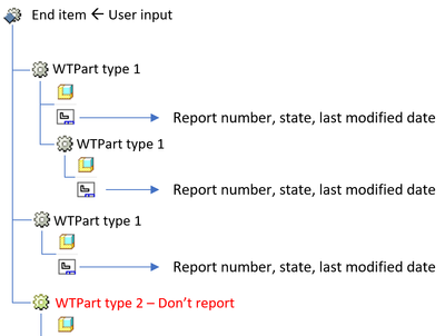

I want to have a report of all CAD drawings that exist at all levels of an EndItem eBOM (so Design view only).
Something like this:
I do have multiple WTPart subtypes and only need 1 type reported on with it's CAD Drawing associations. The idea is to get a snapshot of total quantity of drawings vs. how many are at a particular state (from week to week perhaps). Added complication is that we have Creo and NX and some of the drawings may not be classified as "CAD Drawing" type but instead may show up as "CAD Assembly" with a xxx_DWG in the name.
For input, is it possible to have only the available End Items be selectable via drop down or something like that?

Its very complicated since it involves recursive queries, Config spec criteria and crossing multiple object types. Its near impossible without the UI helping get this for you. I feel your pain. Proper indented structures are our bane as well.

If it were just one or two End Items, it's not so bad...
  1. Product context/Details/filter for desired end item
  2. on Structure page Display/Expand all levels
  3. Display/Select all
  4. Show/CAD Documents
  5. Export/as xls (or whatever format)
Then in excel,
  1. search for drw or _dwg (if NX)
  2. for found, get state
  3. take the list and remove duplicates
  4. make chart with counts/percentages at states
There are many to do :(. And this is so many clicks I can't imagine there isn't something better.
