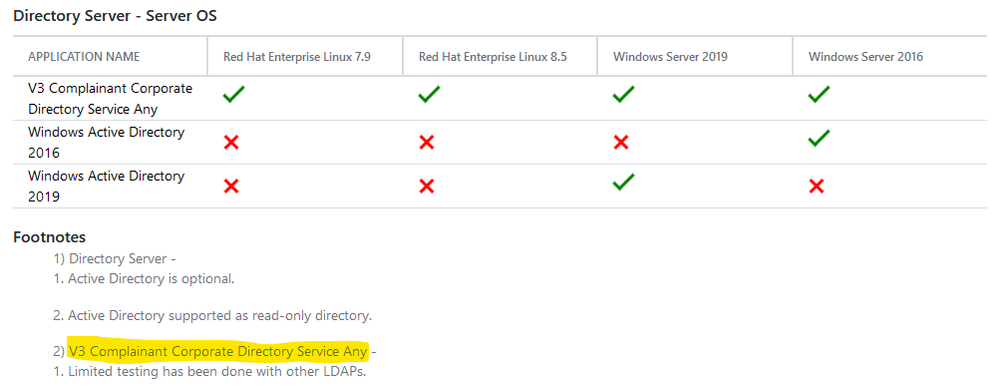

Define 'supported'.  WindchillDS is no longer bundled with Windchill, but any 'V3 Compliant Corporate Directory Service' is compatible/acceptable/approved.
From the Windchill 12.1.1.1 release matrix:
You can continue to use the last available version of WindchillDS as long as you want, but tech support isn't going to take any responsibility for it.  On the other hand, tech support isn't going to help you with OpenDJ either, so is it really 'supported' either?  Both are approved for use with Windchill, but neither one will be 'supported' by tech support.
