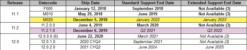

ScottMorris
(To:PRKAC)
For me, the decision to upgrade also depends on how long you plan to stay on a release.
WC11.1 is supported longer than WC11.2.
The other factor is ECAD WGM. Cannot move forward from 11.1 until a new solution is in place.
BenLoosli
(To:ScottMorris)
My question is: Why is an older version (11.1) slated for a longer life than a newer version (11.2)?
I do understand the scenario in Creo where Creo 4 (and Creo 7) is the long term/big company version and Creo 5 & Creo 6 are short term/small company implementations. This makes sense to and is documented.
I cannot understand Windchill doing that as the interaction with Creo is very critical and thus more CPS releases will be needed by 11.1 that will not have the same functionality added to 11.2 in order to support new Creo releases.
I am struggling with a decision as to what our next upgrade should be. We use Creo 4 today with Windchill 11.0 m030. We want to get to Creo 7 and Windchill 12. BUT!  I have to do an intermediate migration to a Windchill version that supports Creo 4 & Creo 7. PTC has stated that Windchill 12.0.0 and 12.0.1 will be short lived and the long life version of Windchill 12 will be 12.0.2.0 scheduled for a Q2 2021 release.
With that said, is Windchill 11.1 or 11.2 the better upgrade choice at this time?
