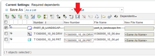

i already saved the format (.frm) in windchil it is also released in state in windchil,,,after that i create one new drawing (.drw) .but when i try to save that drawing the .frm also came like above picture....
is there any possile to break dependency or copy the(.frm) after paste into drawing(.drw)..

(To:HE_9849681)
Have you tried creating a Library for the Formats, and using that location as base for the format for the drawing? Then the format already lives in PDMLink, and won't be picked for check in.
