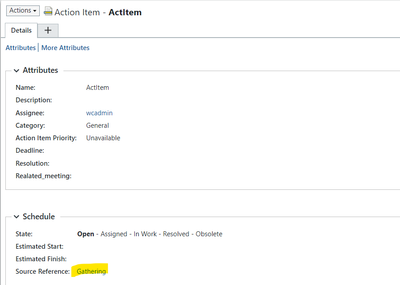

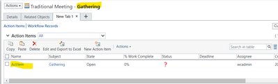

The problem is that I can't get to the meeting object from the action item for those action items created within the meeting.
From the meeting object, I can see the action items, but not vice versa.
During an audit of open action items, it would be helpful to get to the meeting object from the action item page.
When I create an action item from a document object, there is a bitraceable link setup and I can see the document object in the Subjects table.  This is useful!  But I can't see meeting objects when AIs are created from the meeting.

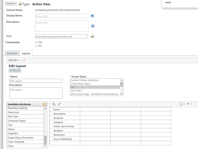

Not sure if I have understood this correctly, you can edit action Item type in Type and attribute manager , on the info page more attribute layout add the source reference attribute :

That worked!!  Thanks
