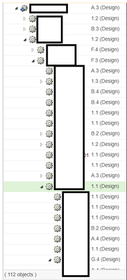

In pictures:
When I select the highest assembly, it doesn't detect that there is changes done to its child parts. (And this is just few level structure)
I have to go to the specific structure that have faced changes or open all sub-assemblies and paint all --> then select & click detect to find that there is something changed.
That is why I want to filter/see the assemblies and parts to see is there "equivalent part exist...." parts"
Also when operating with big structures, sometimes if I select too much parts the detect will just fail.
Filtered picture to get a point that structures go in many levels in my situation and I can't be sure if there is something changed even before I'm starting creating manufacturing view.

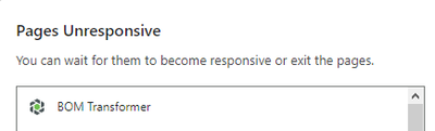

Hi  @HelesicPetr
I tried the following:
Viewing --> expand all levels.
As I mentioned earlier, my structures are big, and I'm facing problems when selecting all.
BOM transformer will show blank.
And will result to this immediately or after clicking detect. (sometimes crash):
So this is why I am looking for the filter to show the parts that have marked with "equivalent part exists..."
With this filter I could use detect function only those.
