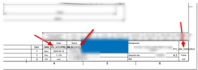

Hello all,
Im having a hard time figuring out why pdfs generated by the CAD worker on Windchill Server has a different behaviour from the drawings manually printed to pdf from Creo Parametric.
From Windchill server, new representation PDF the ptc system parameters doesn't changed with their value, the parameter name remains
- &PTC_WM_MODIFIED:BY
- &PTC_WM_MODIFIED:ON
-&PTC_WM_VERSION:D
See the example:
But if i do it manually in Creo Parametric, thoses parameters are filled with theirs correct values.
Anyone has this issue? How to fix it?
Thanks in advanced
Thank you in advance
Mariana Sousa
Hi all again,
After some hours testing everything, The main route was the Templates Drawings. My customer had his templates with "Switch Dimensions" activated. So of course thoses paramaters didnt update with the value.
Solution: update the templates drawing and click "Switch Dimension" untill the parameters update values. Check-in files.
Thank you everyone!
Mariana Sousa

I am on Windchill 12.0.2 with Creo 9 publishing with CreoView 9.1 Adapters. We do the publishing on the Windchill server and I have never seen that behavior. Is this a new issue or has it been there for a while on your publishing? While I don't use those parameters on our formats, I do use PTC_WM_REVISION:D and a lot of company parameters. Are your other parameters used in your formats coming through correctly? Since you are doing a New Representation of the drawing the files have to be checked into Windchill. Is your server set to retrieve the files As Saved or Load Latest. Not sure this could be the issue but something to check.

Well its the first time my customer is reporting me this, so I guess its a new issue. They already used Worker for publishing files.
One thing i know that all thoses parameters are in the template drawing and this one is based on the format drawing. Yeah this drawing is in Production state already, that's why i could make a new representation, because its there workflow. I need to double check about "As saved" or "Load Latest".

Is this happening with 3D also? Check the Viz files in Creo View and check if attributes are correctly reflected.
Please check the worker log. You can turn on Verbose mode on Worker to get a hook of any anomaly.

Hi all again,
Thank you everyone!
