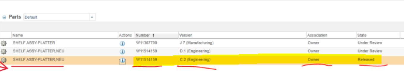

I see one of my CAD assemblys is linked with same WTpart two times. old and new both.
will i face any problem going forward?
If yes how can i remove the old one and what precautions i need to take to avaoid this?
(See attachment)
Thanks in advance...!

But if i edit the association, it will bring the Part to next iteration and the previous one will still carry it?

Hi @Sandy7
Usually it happens if the revision operation is done just with WTPart or CAD Document separately.
BenLoosli
(To:Sandy7)
That is true, but does it matter at that point?
Any future changes will be to the latest iteration.
Alternative is to delete back to where the problem started, but that is usually not doable.
