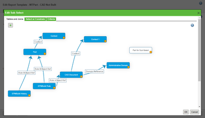

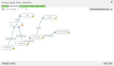

You might find this helpful. This is a report template I created that returns WTPart structures that have not been "built". Just keep in mind that if a WTPart structure is updated after the CAD check in, it will get flagged as not "built" (even if it was built during the initial check in). I have a data monitor that runs weekly to find issues and address.
Another thing to keep in mind is that certain errors in the CAD models (such as failed placements) will prevent Windchill from doing the Build, even if the engineer has it set to build on check in.

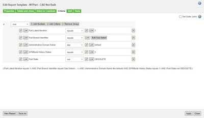

The key criteria is EPMBuild History.Status = 1.
I have Administrative Domain.Name like "default" to help eliminate returning items in Workspaces.
I also am omitting Obsolete parts

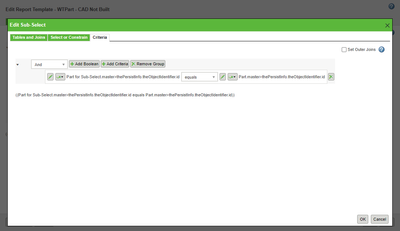

The subselect is just to get latest revisions:
joe_morton_3-1704745179597.pngjoe_morton_4-1704745188664.pngjoe_morton_5-1704745200720.png
Hope that's helpful!

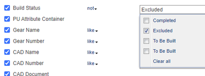

It should appear as 'Build Status' in Query Builder.
rleir
(To:GrahamV)
Here are the options for  PartUsage.Build Status :
but PartUsage does not relate to CADs?
In EPMBuildRule I have no Build Status field. There is a field 'Cad Representation Role' which seems to always be yes. I is that the field for CADSYNCHRONIZED ?
GrahamV
(To:rleir)
Build Status is an indication of whether a WTPartUsageLink was built from CAD (or vice versa, you can build CAD structures from WTParts), it's useful for identifying parts that have been manually structured. Sounds like it's not what you're after though, what are you trying to achieve?
