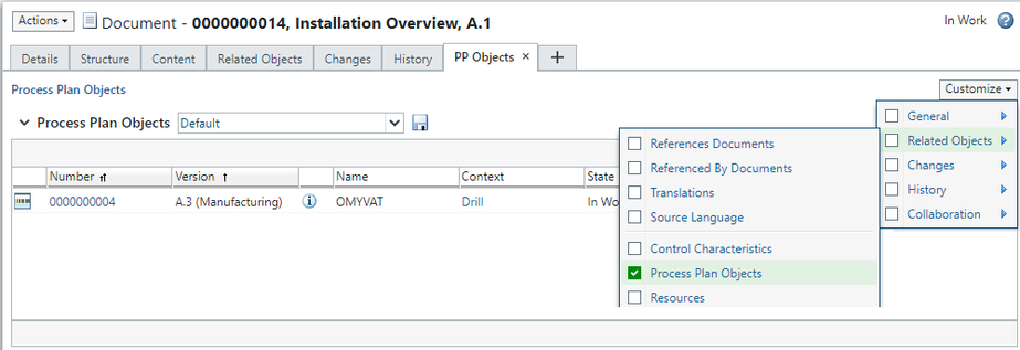

This problem has been addressed in Windchill 13.0.X. A custom table can be added to a new tab on the Document details page.
The table displays related operations, process plans, etc.
