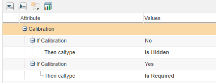

In the cascading attributes section, I have two rules. If calibration is no, hide calibration type. If calibration is yes, calibration type is required. (There is no "unhide" option).

Cascading attributes config:

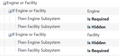

If I have a cascading attribute set like this:

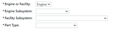

And set a default value of, say, Engine - I'd expect that the default view in the part layout would show the facility subsystem attribute hidden.
Instead, both fields show:
The correct cascading effect only works when I click any other option within the first attribute and then reselect Engine.
