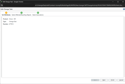

I am facing a problem where the attributes on the first step of the edit change task wizard are not displayed.
This is at wcadmin all the way down to a user with technically the correct access.  I have sifted through all the ptc CS and nothing has fixed my issue.  I can update resulting objects and finish the wizard just fine.  This is on a customized system with little documentation.  13.0.2.0

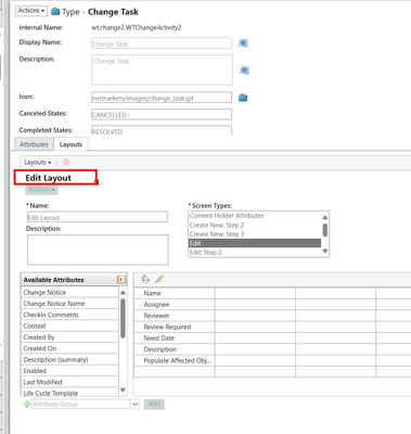

Can you double check the edit layout is set correctly :

Any errors in logs when this happens ?

Nothing that sticks out.

Hi @Wayne.Beck.Gen
Do you use a Profiles? Someone can add you to a profile where attributes can be hidden from the user.
Also check the edit layout settings in the Type and Attribute Management.

They had edited the jsp pages and we dont have any documentation of what was done.
Hi @Wayne.Beck.Gen
That is a very bad situation.
If you do not know how the jsp page has been modified then it is really hard to find root case,
A sharing the jsp pages could help to identify the issue, but I could understand it is not possible
