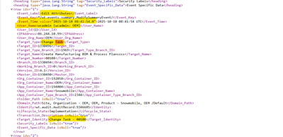

You need to enable modify event for audit . downside it will only capture new events and it will affect all objects

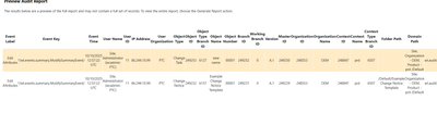

+ preview screenshot
