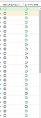

We use AssentComplianceManager to connect Windchill and have flag to WTPart
https://community.ptc.com/t5/Windchill/WIndchill-Product-Analytics-WPA-Where-to-go-in-the-future-now/m-p/787769/highlight/true#M66436
This is an example of one of the Windchill queue sending data to Assent system (it's a SaaS)
This is the Compliance view in Windchill with flag for a code
And this is part of a structure view
