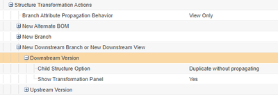

I am using Windchill MPMLink Release 11.2 and Datecode with CPS 11.2.1.7
Is it possible to set default value for field *Child Structure Options: as Do not duplicate
I am not sure on 11.2. But, on my 12.1.2 environment, there are preferences to set the default values. You can check and navigate to Associativity > Structure Transformation Actions > [Action] > [Upstream/Downstream] Version > Child Structure Option  under Preference Management. Sharing a screen grab for reference.

Dears,
sorry for the delay. I'm absolutely new in ptc community and I haven't seen the post.
Great for your solution. In Windchill 11.2 it works as well.
