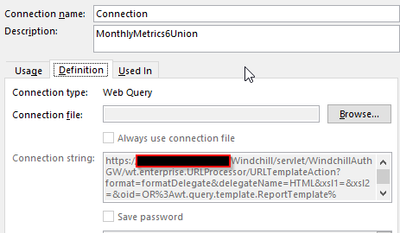

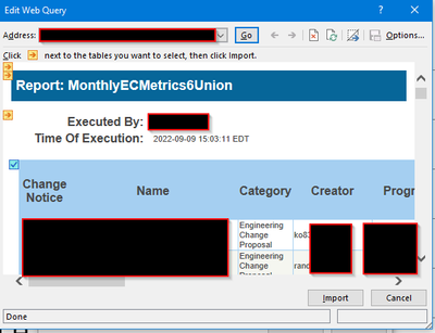

Its possible to pull the report into Excel via and have it pull down data by refreshing. Its how I do all my complex metrics reporting. I pull 4 reports and combine. Does Power BI have the ability to pull data from a web query?
It does have that ability but I am struggling to get it to work because it requires anonymous credentials which my URL is not agreeing with.
I was able to get the authorization to work but Power BI was unable to get information from te web page
Ensure that the report is defaulting to render as an HTML page. The new style of reports has a left slider that accepts query input. By forcing to old style and HTML, it just displays and you can select the table to import. This can be done with the right parameters in the URL.
https://<your host.com>/Windchill/servlet/WindchillAuthGW/wt.enterprise.URLProcessor/URLTemplateAction?format=formatDelegate&delegateName=HTML&xsl1=&xsl2=&oid=OR%3Awt.query.template.ReportTemplate%3A1488903795&action=ExecuteReport
