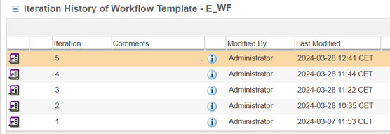

I want to compare the workflows after import, because we often had the case that the developer forgot to export the latest version of the workflow from the integration system to his own developer system. Thus all changes that were already done on integration are lost after importing his workflow. The comparison is there to ensure that a workflow like that doesn't find its way to production
HelesicPetr
(To:FS_9776388)
Understand.
Just one point, The history of the workflow can not be lost. Windchill keeps the iteration history of the workflow even though the updated version is imported from the ZIP
I would say that the xml comparation is the only way I know today.
PetrH
Yes, I do know about the workflow history. It sadly doesn't help us much if we don't notice the error though, that's just really plausible after we noticed that something is missing from the workflow (and it would be bad if that was only noticed on production)
