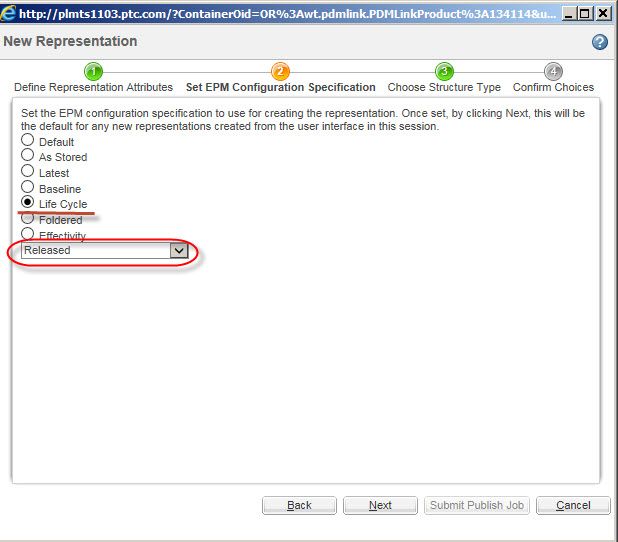

Hi Tom,
Are you trying to publish CAD objects with the following Config spec by default? (see screenshot below) or do you want to publish those CAD objects with 'Latest Iteration at Current Revision' of each dependent model?
I once worked with you when creating the publish utilities publishing jobs based on EPMDocument's object identifier(OID) from a CSV in the article CS211115 and just want to help you creating a article with this custom publisher
Life Cycle Config spec:LC.jpg

I'm not sure exactly what that highlighted option does, but for automated publishing there are only two possible settings - 'latest' or 'as stored'.  Our system is currently configured to publish on check in and then republish again on change (set state to 'Released', etc.)  I'm not sure this option is useful for automated publishing...

Hi TomU,
If we provide an option to publish cad drawing with LifeCycle: Released Configuration Specification in the following article:
https://www.ptc.com/en/support/article?n=CS238377
so Windchill publishes or republishes the representation when an EPMDoc is changed to Released Lifecycle states, would it be a workaround on this issue?
TomU
(To:SY_553166)
Based on what I'm reading in CS230180, no it would not.  'Lifecycle:Released' is not equal to 'Latest Iteration at Current Revision'.  For file synchronization enabled CAD workers (which are recommend by PTC), the 'Lifecycle:Released' config spec will fall back to 'Latest' anytime a 'Released' version is not available.  I also don't seen anything stating that 'Lifecycle:Released' won't jump to the 'Latest Released' during future republish events.  Having a representation use a completely different revision, and especially one this is not released, it not a solution.
I really just need a new config spec. 'Latest iteration of as-stored (or target) revision', and then some way to make it the default config spec. for automated publishing.  Basically a hybrid of the current 'Latest' config spec. and 'mark out of date' functionality, but in a way that won't cross revision boundaries.  It should always use the latest iteration of whatever revision is being requested.  Make sense?
