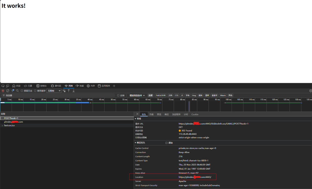

As configure Windchill SSO by following the manual: Security Assertion Markup Language (SAML) Authentication , now we are able to open the SSO login page and login with username/password successfully. But when the browser tries to jump into Windchill home page, it showes error message like 'Failed to process the request, Contact your administrator...'. As checked the method server log, there're debug message like below:
2025-11-17 13:09:14,115 DEBUG [ajp-nio-127.0.0.1-8011-exec-1] sso.shibboleth.sessionHook wcadmin - Query Parameter - return = https://plmdev.xxxx.com:4443/Shibboleth.sso/SAML2/POST?hook=1
2025-11-17 13:09:14,115 DEBUG [ajp-nio-127.0.0.1-8011-exec-1] sso.shibboleth.sessionHook wcadmin - Query Parameter - target = null
2025-11-17 13:09:14,116 DEBUG [ajp-nio-127.0.0.1-8011-exec-1] sso.shibboleth.sessionHook wcadmin - Windchill Domain Name = plmdev.xxxx.com
Just wondering where we can set the 'target' properly so that the sessionHook can handle the request successfully. Any advice will be appreciated...

When you mentioned username/password, I thought it might be a hybrid setup. Do you have your shibboleth configuration that you can share? Please obfuscate any sensitive information. I suspect something is getting dropped in the redirect. I also had issues in the past:
https://community.ptc.com/t5/Windchill/Session-Hook-reverse-proxy-and-shibboleth/m-p/1040537#M87168
In your log, the target is not set.
shlcm
6-Contributor
(To:avillanueva)
Yes, this is a big problem. Just not figure out how to set the target correctly.
Here I attach the shibboleth configuration files below:

After set
sessionHook="/Windchill/sso/shibboleth/sessionHook?target=https%3A%2F%2Fplmdev.xxxx.com%3A4443%2FWindchill%2F"
in shibboleth2.xml, the error message is gone after login. but now it redirected to the Apache welcome page instead while we want the Windchill home page actually. Have any idea?😂
As checked the browser network info, it shows the Location header of /Shibboleth.sso/SAML2/POST is set as Apache home page.
Temporary solution is by modifying the OOTB javascript file: codebase/netmarkets/javascript/sso/shibboleth/sessionHook.js
this.submit = function (){
                    restoreTo(params["target"]);
                    isInvalid = false;
Will go on finding the real final solution...
avillanueva
23-Emerald I
(To:shlcm)
Ok, this is progress. What's being lost is the redirect URL which should take it to the specific Windchill URL you asked for before you did the SSO redirect dance. It is supposed to encode that and extract it later when done. Let me review what's you've posted, compare to my setup and check notes.

avillanueva
23-Emerald I
(To:shlcm)
I check my settings and for the sessionHook, it should be just this:
sessionHook="/Windchill/sso/shibboleth/sessionHook"
By putting the target attribute there, that is why its forcing to Apache page. This should be getting parameterized for you somewhere but does not need to be forced.
Also, I noticed that your entityId was different than mine. Not sure if this matters:
entityID="https://<my FQDN>/shibboleth"
The issue lies somewhere else. Its not in the attributes mapping.
