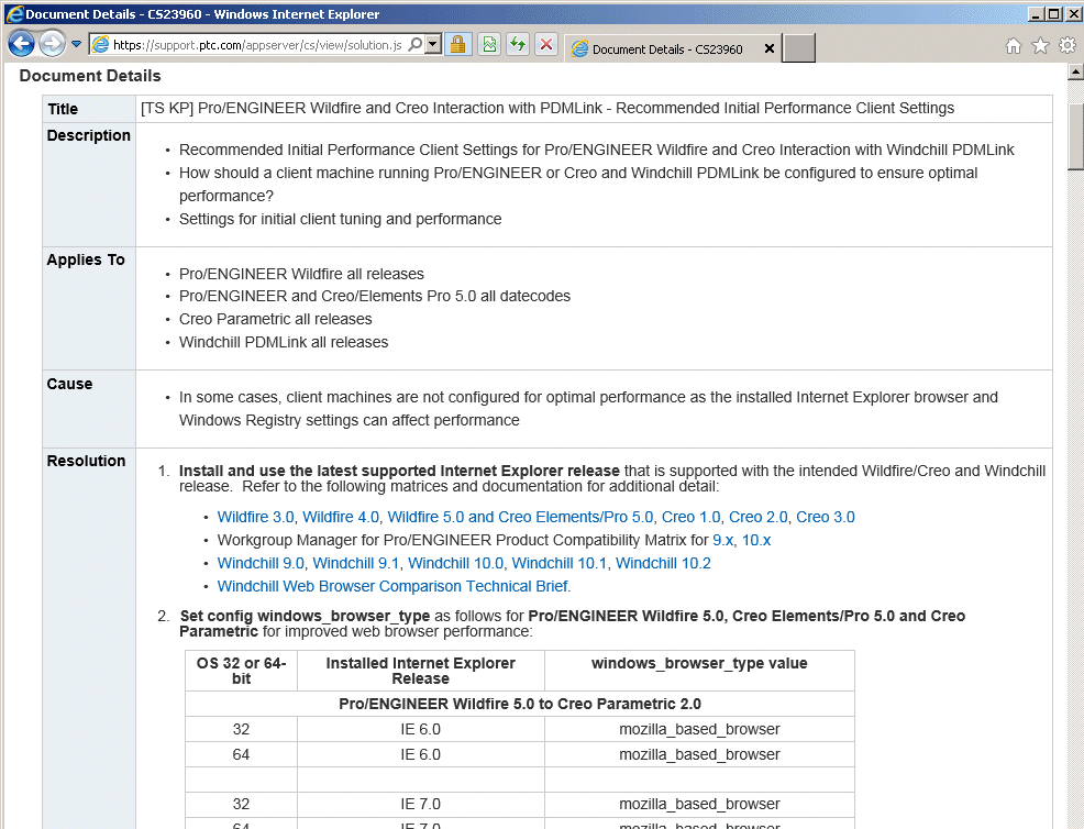

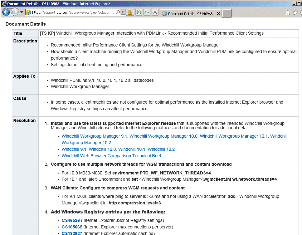

Technical Support has created a set of Articles that is the basis of the configuration we’ll be walking through.  Review and bookmark the following:
[TS KP] Pro/ENGINEER Wildfire and Creo Interaction with PDMLink - Recommended Initial Performance Client Settings
[TS KP] Windchill Workgroup Manager Interaction with PDMLink - Recommended Initial Performance Client Settings
Configuring a Creo Client (CS23960) or Windchill Workgroup Manager Client (CS140968😞
Clients are quick and easy to configure as there are a small number (5 or 6) of changes to make when configuring:
  1. Update to the latest Internet Explorer release available from Microsoft that is supported with your Creo and Windchill release

  2. Set config windows_browser_type (Creo) or wgmclient.ini preference windows.browser.type (WWGM) to the most performant browser release
    Config windows_browser_type or preference windows.browser.type can be set to configure the client to use an in-process Internet Explorer release (Creo/WWGM), out of process Internet Explorer release (Creo only), bundled Mozilla browser release (Creo/WWGM) or bundled Chromium browser release (Creo 3.0).  Refer to the table in the article for more detail and choose the browser type that performs best.
  3. Set config dm_network_threads (Creo) or wgmclient.ini preference windows.browser.type (WWGM) to a higher than out of the box value to more fully utilize network bandwidth when downloading content from the Windchill server
    When downloading content to the Workspace during an Add to Workspace or Check Out operation, clients may not fully utilize available network bandwidth (Creo or the WWGM will typically only download using two network threads).  If network bandwidth allows, making this configuration change in combination with Windows Registry settings (#5 below) will improve content download performance.  Refer to the article for more detail.
  4. Set config dm_http_compression_level (Creo), environment PTC_WF_NETWORK_THREADS (WWGM) or wgmclient.ini preference wf.network.threads (WWGM) for WAN clients
    Enable compression of information and content being transferred between a client and Windchill server where the network bandwidth between the client and server is limited (typical in WAN environment).  Refer to the article for more detail.
