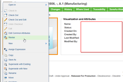

But what happened is related to the old manufacturing views in the system. The old ones have the previous lifecycle, which is totally fine. However, after creating the OIR, the system no longer allows me to revise the old manufacturing views. This is really weird because the old design parts that have the exact same lifecycle still have the revise option.
Somehow the lifecycle and view goes now hand on hand. I tried to assign new lifecycle to part which is manufacturing with old lifecycle and after the new lifecycle is assigned also the revise option became visible. Tested also other way and the revise option disappeared.

Lifecycle what was used for design and manufacturing - no revise option. Tested with different rights.
If I try to revise part from BOM transformer it gives:
With new lifecycle manufacturing view does have revise option

So its the existing MFG views that are not in line with the current OIR and Lifecycle? You just need to change their lifecycle to the new one to clean up history. This should be easy to do from a search results. You can do them in mass and change the lifecycle template. That should resolve the issue.

If you revise, the system control the target object and if the target object's LC has the rights to create revision..
For example, if you revise object that has old Lifecycle template and new OIR rule would change the LC template to different one (which is possible) there has to be correct transition definition in both templates
