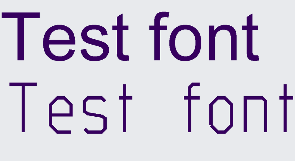

Has anyone found a way to control Creo View Resolution, especially of text?  It is very grainy and hard on the eyes.  It would be a bonus if text could be recognized as text!
We are currently still using the default home grown ProE "stick font" (not TTF and not OTF) simply called "font".

For a stroke font you can not to control the quality, I recommend to use a ttf font.
Yes, we want to do that once we go to Creo 3 (since that version made it easy to format TTF and OTF fonts).

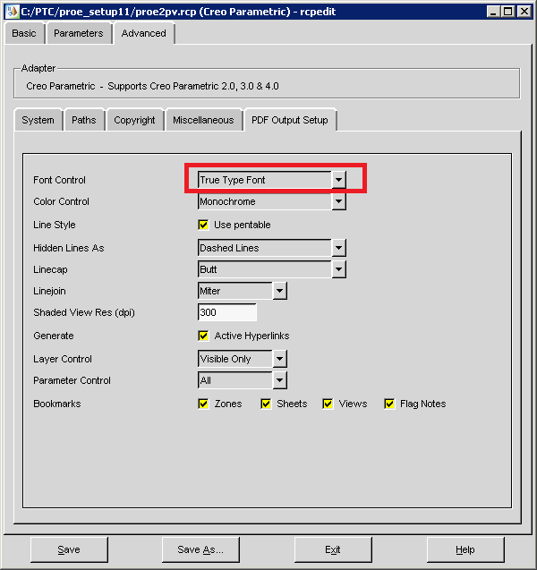

You can use the "True Type Font" value of the "Font Control" propertie in your proe2pv.rcp file.
And need to change your ndx font file.
