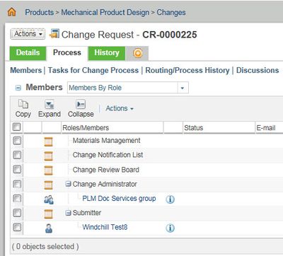

We require that authors of Change Requests populate the Change Review board (CRB). As most users submit CR's to the same people every time, its helpful for those users to Copy a list of users from a role from one CR into anther.

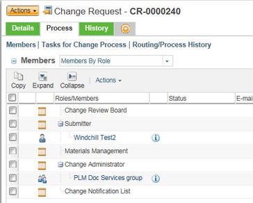

The users in the same role in M010 can do this, but for some reason the users in M020 cannot do this. They do not see the icons for paste. They do see copy.
I have checked the Configuration Actions for Roles and do not see anthing obvious that would hide the paste icon. I have also checked the Access Policy - again nothing that would hide the action.
I am using the same CR workflow and Team.

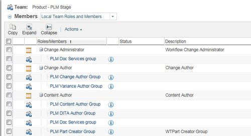

This is what the CR author users see:

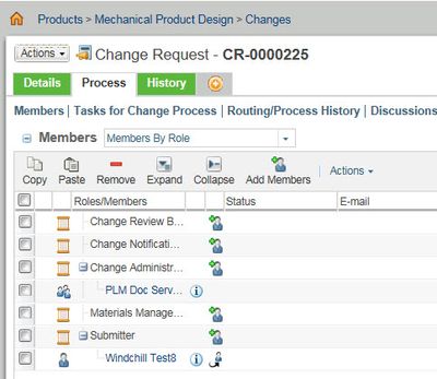

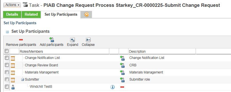

Those same CR authors can edit the CR and they can edit the team on the task to submit the CR:

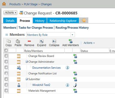

or i have also checked for paste option in the Change request it is only availble to Administrators not for other users.

This is a change that I see from my test enviroment on M010 (that has the ability to copy and paste on the CR team) and M020 where the paste icon is gone. The users can modify the team on the submit Change Request task, they just cannot modify on the CR!

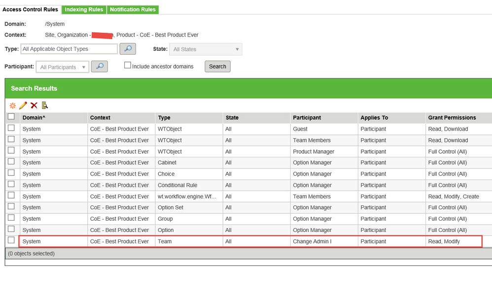

This is because your CR authors do not have modify access to the team. With out this access control, the only way to modify the team is using a setup participant task.
If you have a use case where you want a specific role to modify the team, then you need to grant modify access to the team in the system domain.
Say you want Change Admin I to modify the team, you need to have something similar to the below in your policy.  Remember this is a global policy for team, with this role will be able to modify any teams to which they have access to it, you can of course filter to allow on certain states.

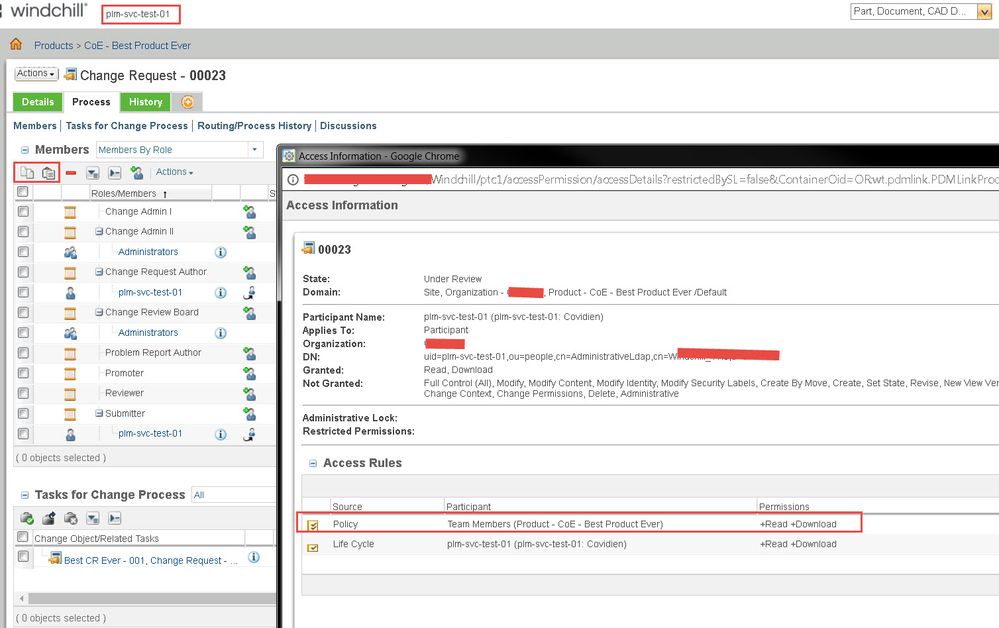

The users have access to Copy and Paste in the configuration actions per role in the Team.

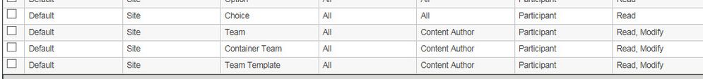

I added the ability to Read, Modify "Team" and also "Container Team" for that same Role. I did this at the Org level and then again (after testing) at the Site level. No affect.
They can still not Paste in the CR process tab. They can also not modify the Team on the Product/library team view.

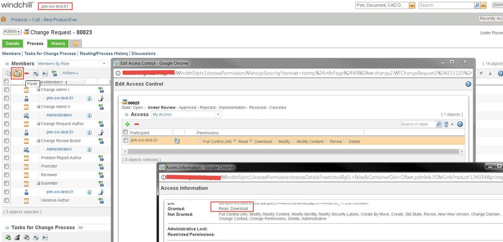

Yes. I started at Org and then tested to see if the user had the icon for paste (they did not) and then checked the Team page view.
I then added the permissions (Policy Administration) at the site level (Domain/Default) for Ready. Modify.
I tested with Typev for Team and then also Team Template.
