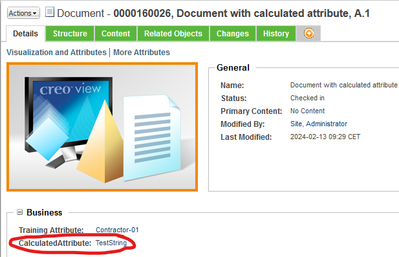

Can you define a calculated attribute for type "Uses Occurrence Attributes"?
For the type "Uses Occurrence Attributes" I've tried to define a calculated attribute of type String (see attachments). However, when looking at the Occurrences table no value is displayed for this attribute. I wonder if it is in general possible to use calculated attributes for Uses Occurrence Attributes.

Hello @HelesicPetr,
the formula is "TestString" just to see whether there would be any output.
However, the SimpleCalcAttrib column in the Occurrences tab just stays empty:
I've tried the same approach on a WTDocument, where it worked:

Hi @FS_9776388
If you add the calculated attribute on the WTDocument to the structure view, does it work?
PetrH
Can you tell me how to do that? I'm not really sure what you mean
HelesicPetr
(To:FS_9776388)
Add the wtdocument calculated attribute to the structure.
PetrH
That does work. I don't quite understand though how that relates to the Occurrences table?
HelesicPetr
(To:FS_9776388)
It could have been a GWT issue
