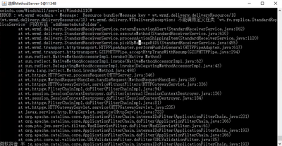

I am using Windchill PDMLink Release 12.0 and Datecode with CPS 12.0.2.0
Create mount for root folder "vault1" failed. Nested exception is: wt.util.WTException: Creation of subfolder below root folder "vault1" failed. A physical folder corresponding to the root folder mount path "D:\cnitWcVault\vault1" does not exist.

D:\cnitWcVault\vault1 exists. If it does not exist, the following error is reported:
Create mount for root folder "vault1" failed. Nested exception is: wt.util.WTException: Some of the mounts are not valid D:\cnitWcVault\vault2 - not exist

Can you activate wt.fv logger ?

It means:
Wt. WRMF. Delivery. WtDeliveryException: can't invoke the definition in the class "wt. Fv. Up. StandardReplicaServer" method in "addRemoteAutoFolder"

Google Translate helps.  The Simplified Chinese line reads...
(wt.wrmf.delivery.deliveryResource/18) wt.wrmf.delivery.WTDeliveryException: The method "addRemoteAutoFolder" defined in class "wt.fv.replica.StandardReplicaService" cannot be called. "addRemoteAutoFolder"
Which suggests this article:
https://www.ptc.com/en/support/article/CS404482
No,it is not userful

Hello ZL_10908440,
Please also share full log file (in english).
