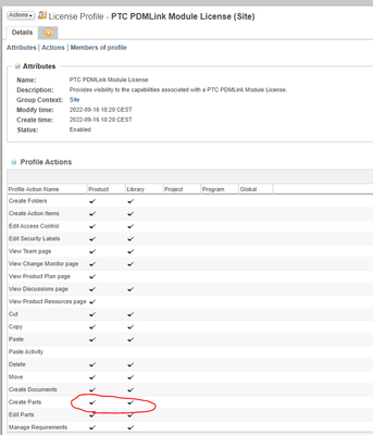

From 11.1, the actions you can perform depend on the license profiles you have been assigned to
Under Site --> Profiles you can find the existing profiles
For each one the actions available in the various contexts (Libraries, Products, Projects, etc...) are indicated.
See below image

Hi @bbusschers
The action availability also depends on what ACL rules are granted to you by roles in a context team.
License group can change a visibility of the new WTP action button as @Marco_Tosin  mentioned .
You need to check it with your system administrator
PetrH
