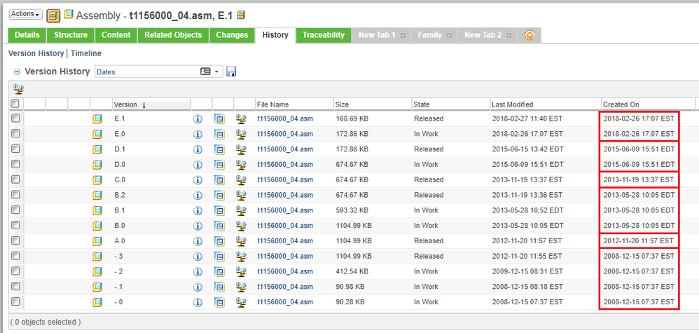

The database shows created as static for the master (epmdocumentmaster), but variable for each Revision (supplemented by each Iteration for each Revision).

Same behavior here.  Created on follows the revision creation.

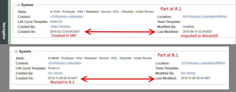

Out of the box, the 'Created By' and 'Created On' are linked to object Revision - we basically never use it because of that.
  • We've had engineers/designers try to use 'Created By' and 'Created On' in the drawing only to find out that it resets with the next revision.
  • A resetting 'Created On' date makes it difficult to this date within the ModelCheck Condition File to exempt old files from newer stricter rules.
