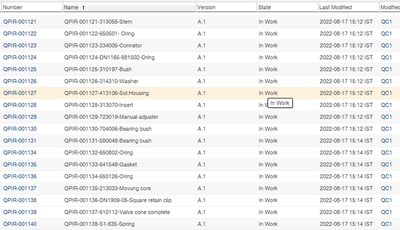

Because I am facing the following problem:
I have a bunch of documents with file name as auto number format.
Some times my file name and auto number are matched like case 1.
Case 1:
Document name                         Auto number
Test_1                                                001
Test_2                                                002
Test_3                                                003
Test_4                                                004
Test_5                                                005
Some times my file name and auto number are mismatched like case 2.
Case 2:
Test_1                                                001
Test_2                                                003
Test_3                                                005
Test_4                                                002
Test_5                                                004
I need my file name (auto number format) and the windchill generated auto number should be matched.
Actual case:
Name QPIR-001121 to QPIR001131 are matched with auto number.
Name QPIR-001132 to QPIR-001140 are mismatched with auto number.
All documents are uploaded in single shot.
Any ideas are welcome.

I don't know exactly the logic how the documents are sorted during mass creation now.
I can just guess that it can be by last modification in a wizard or last modification of filename on a local disc and so on.
I can see that in your case it is not definitely sorted by name as you could think.
btw do you use Wizard to mass creation of documents or do you use Upload Documents from Compressed files?
It can have different behavior.
Maybe if you need to keep same number and name, you could define OIR rule that a name equals number.
There could be another case. Another user created some documents that time and stole the number :D.

Hi
We have tested the case as below.
File name                                  last modified time                                auto number
Bulk upload test 1                      8.24                                                          GND-001156
Bulk upload test 2                      8.25                                                          GND-001157
Bulk upload test 3                      8.25                                                          GND-001158
Bulk upload test 4                      8.27                                                          GND-001159
Bulk upload test 5                      8.26                                                          GND-001160
Any idea?

Hi
How it is ok.
Look at Bulk upload test 4  and Bulk upload test 5. The last modified date of Bulk upload test 4 is later than Bulk upload test 5. But still the auto number is matched with file name.
Another example;
Thank you.
Hi @Sathish_Rosario
I meant that autonumbers match the file names. I didn't see the modification time.
So good test. Now you know it is not dependent on the value of modification time.
So it could be dependent on a different thing
PetrH
