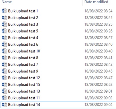

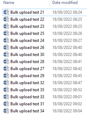

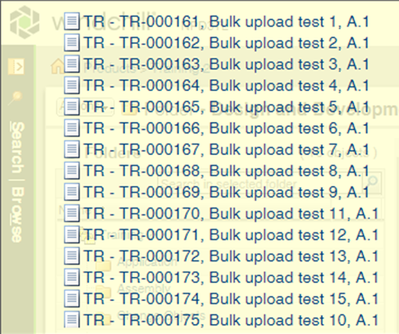

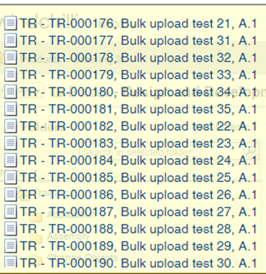

Hi
We have tested the case as below.
File name                                  last modified time                                auto number
Bulk upload test 1                      8.24                                                          GND-001156
Bulk upload test 2                      8.25                                                          GND-001157
Bulk upload test 3                      8.25                                                          GND-001158
Bulk upload test 4                      8.27                                                          GND-001159
Bulk upload test 5                      8.26                                                          GND-001160
Any idea?
Thank you.

Hi
How it is ok.
Look at Bulk upload test 4  and Bulk upload test 5. The last modified date of Bulk upload test 4 is later than Bulk upload test 5. But still the auto number is matched with file name.
Another example;
Thank you.
Hi @Sathish_Rosario
I meant that autonumbers match the file names. I didn't see the modification time.
So good test. Now you know it is not dependent on the value of modification time.
So it could be dependent on a different thing
PetrH
Yes.  you are right.
