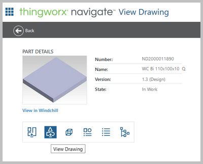

I would also advise to have a look at Thingworx Navigate, which is much better interface for users who just need to find a drawing.
That is also an option, buthow does ThingWorx know which drawing to show for a Part, in some cases we have only calulated association between WT and Drawing? This is why I was hoping we could move entirely towards WTDocuments for drawing storage
Calculated association is the default setting for drawings in relation to wtparts. Using Navigate app View drawing will give you the associated drawings.
