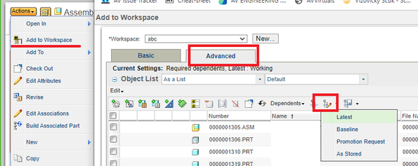

We use Windchill and Creo 7. When I opened a Creo drawing for an assembly, the 3d model shown is of old iteration. Tried to update the workspace but still the problem persists.

Hi @KSHITISH_S
Here you can set the preference what you want to add to the workspace
hope this can help
PetrH

Hi @KSHITISH_S
The drawing has old reference to a previous model iteration.
You need to checkout the drawing
update the model in the workspace to the latest version,
Open drawing and update the model in the drawing to the latest model.
Save and check in the drawing.

You should check your download rules. If they are set to Load As Saved, it is very possible that you could get an older iteration of the assembly when loading a drawing. We have the rules set when opening a file in Creo to use Load Latest. However, when doing a download to workspace in Windchill, our rules are set to As Saved. This has caused some issues for some of the users who do not understand the rules of Windchill.

@BenLoosli is right.
There are several rules that applies during add to workspace operation
for example if you open the drawing the configuration is set as stored configuration.
If you add an assembly as a first part you will get usually latest configuration

 @BenLoosli Thanks for the reply.  Can you please elaborate where the settings are. Are the settings in config.pro or they are in Windchill > my settings > preferences?

Hi @KSHITISH_S
hope this can help
PetrH
