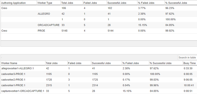

Generally, if there is a problem that a regular user might have, so will the publisher. We sometimes find assemblies that fail to publish. Examining the logs, you can often find the problem model which will cause all assemblies above it to fail to publish, poison pills. If you fix that model, it can fix the failures on up. That does not appear to be what you were seeing. Running in interactive mode will allow you to see what messages the publisher got stuck on. I will have to take a look at that config.pro since it has some good settings to avoid interactive messages.  Keep an eye on your stats. Here are mine:
