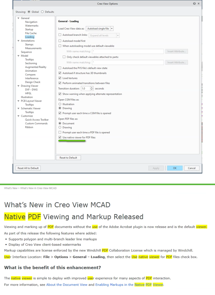

Since you mentioned this happens with PDFs, maybe it's related to the new native viewer feature that came in at 7.1 I think.
I know it also caused issues with markup and annotations, find (CRTL+F) and even basic stuff like copy/paste.
Perhaps you could try un-ticking that feature?
berny2U
(To:rhart)
When I tick it off, I do not get any output, no more printing. Apparently it needs this setting. Any other educated guesses ?
