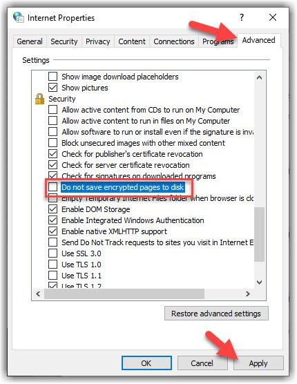

We were getting an INET_DOWNLOAD_FAILURE Error in our logs and found that unchecking this box resolved the authentication issue.
  • Launch inetcpl.cpl > Advanced Tab > Under the Security section > Uncheck the box for "Do not save encrypted pages to disk".
