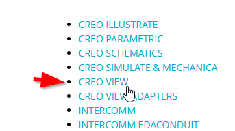

https://support.ptc.com/appserver/auth/it/esd/product.jsp?prodFamily=DVV
There are licenses for Creo View MCAD/ECAD and others. Creo View Lite is not licensed.

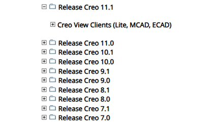

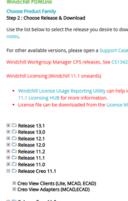

The Creo View clients are downloaded under the Windchill PDMlink area, under the Release Creo (version).
Not sure how Creo View is licensed. There is no entry under the modules for Design Essentials or the other Creo licenses we have.
Since the download is under the Windchill area, it may be part of Windchill licensing which is its own nightmare.

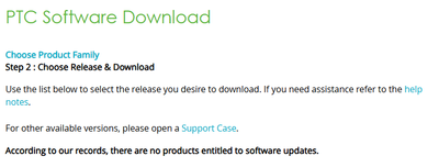

Guys, thank you so much for the replies.
Windchill licence comes from our client. We have installed it before, I believe from an instalation file the client sent us.
Our company doesn't have any entitled download for Creo View at the Support/Download page.
Even though Creo View Lite should be included in each othe software, right?
"It does, however, require another legal PTC license for using Creo View Lite
Otherwise, it can't be downloaded from PTC Website"
