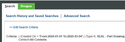

Hi Guys,
Can we obtain the total data from Windchill using export to spreadsheet, but the problem is I have more than 5 lakh data.

I think below can help you:
  • Depending on the memory allocated to Windchill you may decide to lower or raise this value
  • Increase the value of com.ptc.jca.exportRowLimit
  1. Launch Windchill Shell and execute the command xconfmanager -s com.ptc.jca.exportRowLimit=*** -t codebase\wt.properties -p
    where *** is replaced by a number e.g. 80000
  2. Restart Windchill
Notes:
  • Be aware that a high value may cause memory shortage and MethodServer instability
  • The new limit does not work for "XLS" and "XLS Report", because older Excel versions are limited to 65531 rows
    • Use the XLSX export instead
PTC support Article for same: https://www.ptc.com/en/support/article/CS52471
