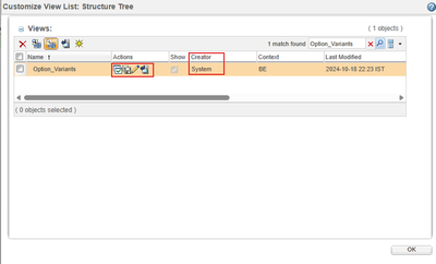

I am trying To Delete Custom Table view which is created as System Table view and hence no option available for delete from UI and as i want to do it using loadfromfile Utility any one have come across this..

If you log in as an administrator why do you not use the delete button from the table menu?
What error do you see if you use it?
I guess that you use a load from file functionality without specify a user so you can not delete it. as a system
This is a consequence of your action.
So the resolution is: delete it from a database or change the owner in the database. There is no UI operation that can help.
I have one advice. If you use load from file and you do not know all consequences really use a backup on your developer(test) system before you do it in a production. . You can revert the backup when ever you need.

Hello Custom tables are created by users , can elaborate on   "Custom Table view which is created as System"
Fede
Hello @Fadel i have created Customized Table View for Structure tab but that view is saved with "System" as  creator and its does not have option to delete in UI and so i am sharing below image for reference so my query is if its possible to delete a table view which has Creator as "System" from LoadFromfile utility :

can you import , run and share result of attached report when running mention the tableview name :
Fede
Hello @Fadel
PFA the Result screen shot below:
